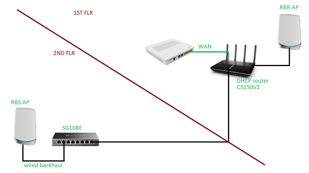

Ethernet backhaul cause satellite to disappear and everything connected to router
I have RBK752 in AP mode connected to my existing network and everything is fine. The issue starts when I connected the satellite for ethernet backhaul. What happened was I cannot see the satelli...
- Nov 30, 2021
Yes, any RBS ethernet connected, switch or not, needs to be connected behind the RBR. Router or AP mode.
Aizal
Nov 30, 2021Aspirant
I presumed the same at first but the thing is right now my RBS is connected to RBR through that very switch and it works fine.
The only thing I changed was instead of the switch connected to my main router, I moved it to connect with RBR instead, so its no longer connected parallel but instead direct.
Nov 30, 2021Guru - Experienced User
- AizalNov 30, 2021Aspirant

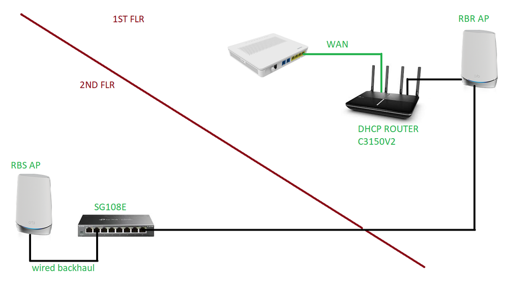

Apparently so. I just got confused with the 3rd example in here though.
I'm trying this configuration but it does not work. Would love to get this to work since I can play with placement of the RBR more as only 1 cable involved.
- FURRYe38Nov 30, 2021Guru - Experienced User
So the 3rd picture with switch is not working in that configuration? I thought you said it was working in your previous post?
This is the configuration following that 3rd picture which doesn't work.
RBR < C3150v2 > SG108E > RBS
I have ethernet backhaul working by unplugging the SG108E from C150v2 and connect it direct to RBR.
C3150v2 > RBR > SG108E > RBS
