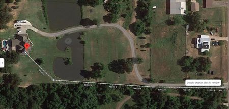

Extending Signal Outdoor to gate.
I have added a video/Call box to my gate that is 850' from the house. There are trees that keep it from being line of sight. I have 2 options.. Run Fiber Optic (best solution but expensive) from the...

Thats kind of what I am asking. It looks like that product is no longer made, and with my Orbi system I am limited to what I can tie into it. So is it posable to use access points that are not Orbi's to extend my signal, if the start and stop points of the AP are wired. I am sure there is a technical way to say what I am trying to coney. Sorry I do not know the terms.
