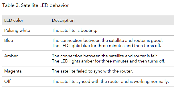

        • Turn on the satellite in the outbuilding and see if it gets a "Good" connection to the system.
          From page 11 of the user manual:
        • If the result is a "Good" connection, then moving a satellite to the outbuilding or purchasing another satellite to place in the outbuilding will result in extending seamless WiFi.
          Background:  The default link between Orbi 350 units is a 5G WiFi signal (channel 157 in North America and channel 108 in the rest of the world.)  5G WiFi has tremendous capacity, but is affected by distance and building materials.  Netgear recommends placing the units close enough together to result in a "Good" WiFi connection (Blue  LED for three minutes).  The connection is strongest (and fastest) when the units are very close together.  Placing units close to each other, however, does not expand the area covered with strong WiFi very much.  As the units are placed farther and farther apart, the total coverage area expands, but the connection link suffers.  The "sweet spot" inside most houses is "around 30 ft." (10 meters).  Obviously units require electrical supply and thus are not likely to be placed in the middle of rooms, so people make a compromise that results in covering enough space with strong WiFi and still having a "Good" connection between units.  20 meters of open space (no walls. no furniture.) might still be close enough.
