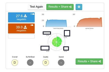

Fake advertised speeds Orbi RBR850
Hello, We recently purchased the RBK853 AX6000 system to provide coverage for my home which is roughly 6,500sqft. We've updated the current firmware and done a factory reset from the start. Now I...

Is LAG disabled on the CM modem?
What are the wired speeds with the wired PC connected to the back of the RBR using Ooklas installable speed test app?
AC client wifi will max out at around 400-500Mpbs depending upon mfr design and support. Will never see anything near 900Mpbs. Wired connection with a PC should see near 900Mpbs or over...
Heres what I get with my Orbi AX sysetm on a Mac Book Pro 2018 wirelessly connected to the RBR:
Be sure to power OFF The ISP modem for 1 minute then back on when rebooting the RBR.
Is Armor enabled on the RBR?
You can find other speed diagnosis steps in the community faq: https://community.netgear.com/t5/Orbi-AX/Community-FAQ-My-Orbi-speeds-are-slow-inconsistent-and-don-t-my/m-p/1982974/highlight/true#M7849
