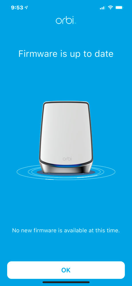

    But this is what I get with the latest installed:
  • FURRYe38's avatar
    What is the Brand and model # of the ISP modem/ONT that the Orbi RBR is connected too?
    What iOS is on your iPhone...
    iOS app is working here: Iphone 12 Max 14.4
