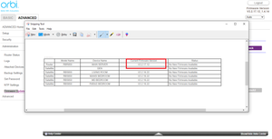

My RBR850 is updated but my RBS are not getting updated.

Have you tried manually updating firmware to it?

For RBR i was'nt taking the update from internet, i have done it manually, but RBS i am not able to do it.
- FURRYe38Mar 03, 2021Guru - Experienced User
Are you logging on to the RBS web page and sending the FW direclyt to the RBS there using there web pages? You can do this if the updating process doesn't work from the RBRs web page.
Manyally download the RBS FW file and then log into each RBS and push the FW file to each RBS.
