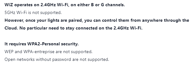

a) I have around 40 IoT devices connected to my guest network (mostly wiz wifi lights)  that every once in a while (1-2 weeks) are not accessible via their app

    The 2.4G channel setting affects only the router.  WiFi devices scan the entire set of channels looking for an access point that has a strong signal and offers an SSID that they recognize.  "Auto" means that the router scans the 2.4G channels and picks one of them based on some algorithm that is not documented.  Some users prefer to specify the 2.4G channel based on their own analysis.  If the 2.4G channel is changed, all of the WiFi devices will soon find it.
    Information about the 5G and 6G capability is not relevant:
    They went for the oldest (and cheapest) 2.4G WiFi chips, not even supporting 802.11n (2009).
