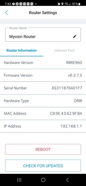

I've had lots of problems with my Orbi. I have spent so much time with Level 2 on the phone trying to get my Orbi stable. I ended up hardwiring all my satellites because the wifi backhaul was so poor...

What firmware is on the satellites? usually you want to upgrade the satellites firmware first and then the router.
Do they show up through the browser gui and not the app? I've had issues with the app not displaying satellites before.

Two of the satellites are through a switch.
Through web browser I logged into system and was able to update the satellites. I set the system to auto update firmware.
The satellites are back online.
"Maybe" it was the app not showing the satellites. I had SO much trouble with the this netgear set up that I periodically check the app to see if everything is online. I guess I should check via the web browser interface.
