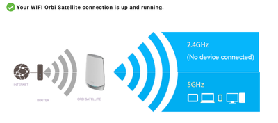

I tried connecting to the satellite and saw the status below. Shouldn't the router and satellite be connected wirelessly also besides a wired connection?

Do you have the RBS ethernet connected to the RBR? If so then the wifi signal on the RBS will be grayed out.
You might turn down the power on the RBR to 50% as well and check. Under Advanced Tab/Advanced Settings/Wireless Settings
