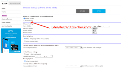

I have the RBRE960 router. This is what I did.

- schumakuJan 10, 2024Guru - Experienced User
This does disable AX for the 5 GHz band from what I see on the UI - limiting to 5 GHz to AC standard only - is this what you are looking for?

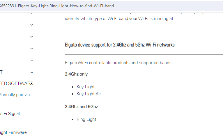

Unfortunately, the Elgato Key Lights are notoriously finicky to set up and get connected to WiFi. I tried connecting them to the IoT network but that did't work.
...and only the Elgato Ring Light - but not the Key Light and Key Light Air are supporting 5 GHz ... so I tend to say these devices don't care about the disable 5 GHz AX features.
- FURRYe38Jan 10, 2024Guru - Experienced User
Yes, as mentioned, unchecking the 5Ghz AX box only disables the AX mode on the 5Ghz radio. Does NOT disable the 5Ghz radio what so ever. Sounds like the devices don't like AX mode maybe.

- swittersJan 10, 2024Apprentice
I have the older Key Light (Mark I). The tech specs on Elgato's site explicitly say it's only compatible with 2.4 GHz networks and WPA/WPA2.
However, their newer Key Light (Mark II) says it's compatible with 5 GHz (and still only WPA/WPA2).
I will try connecting the Mk I lights to the IoT network again. It looks like it's setup correctly to me with 2.4 GHz only and WPA2. Right?
