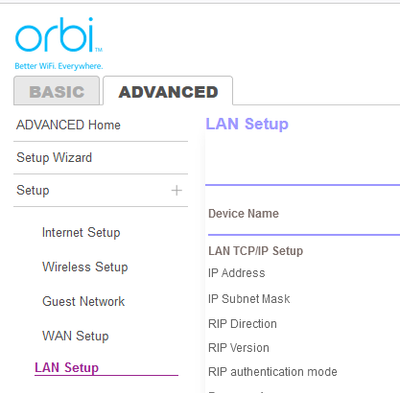

How do I adjust RIP settings on RBRE960 router?
I'm having a hard time connecting some Elgato Key Lights to my network. I did some research on r/elgato, and several users said the solution is to enable RIP (routing information protocol) in the rou...
- Jan 09, 2024
The Orbi app does not provide access to any "advanced" functions. Settings for RIP can be found on the orbi web interface http://orbilogin.net Advanced Tab:
p.s. Most "Internet of Things" (IoT) devices work just fine without changing any of the default Orbi settings.
