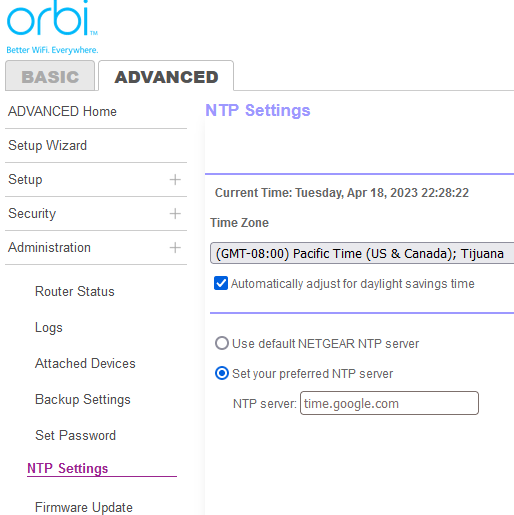

I have parent setting set up on a device to define bedtime from 10:30 PM - 7:15 AM. It's 11:15 PM, and when I look at the status of this device in the Orbi app, there's a green light next to indicating that it's still online. (Right?)
I'm using the Orbi app. I can't find a screen that shows me what time the router thinks it is.

    This appears to be (yet another) time to open a web browser to http://orbilogin.net using the router credentials (not the 'app' credentials). The router uses "admin" and a password. (not the 'app' password. not the WiFi password).
    (many browsers will complain about the web site being "insecure" because of the self-signed SSL certficate.  Look for an option in tiny print to "go to this web site anyway")
    The current time can be found on the Advanced Tab, Administration menu, NTP settings:
