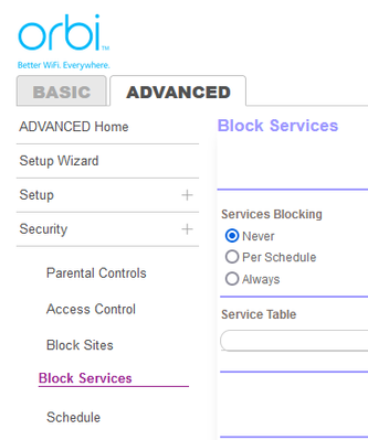

    While more knowledgeable people offer constructive suggestions, can you please verify that the web interface Block Services has not somehow accidentally been set?

      Ping 8.8.8.8 works, but now it's cascaded to wireless devices and is very sporadic, devices will connect then disconnect.  I've just ordered 3 new switches to rule them out.  I have 92 devices, but only 41 of them say connected.  Yes, I did confirm that there is nothing being blocked.
