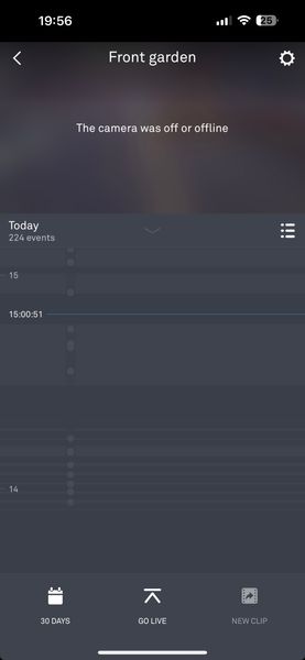

Huge problem with Nest Cameras and RBRE960 V6.3.7.10_3.3.3 🙁
Dears, I am having a huge problem with my Nest Cameras disconnecting all the time. I have 3 outdoor nest camera 2 infoor and 1 Nest hello doorbell. I was ussing this cameras with Asus AP then...
