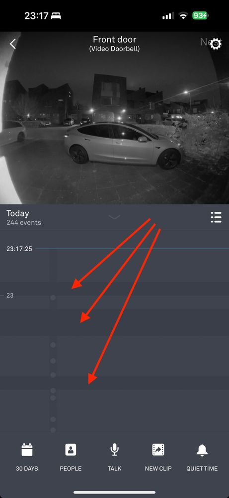

Dears, I am having a huge problem with my Nest Cameras disconnecting all the time. I have 3 outdoor nest camera 2 infoor and 1 Nest hello doorbell. I was ussing this cameras with Asus AP then...

😀 the Router and the satellite in the living room are max 10 meters, but I am planning to connect it with a LAN cable like the satellite on the 1st floor.
So after turning off the 2 AP's at 22:30 I see a lot of disconnects at my cameras again 😞 Same issue!
Let me disconnect the AX at 2.4Ghz and test like that.
