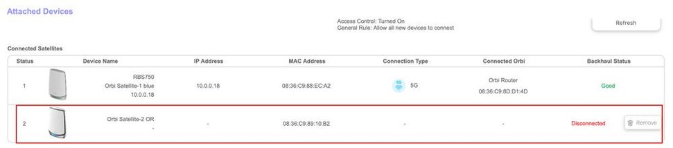

The verison is V4.6.5.14 on RBR750 and RBS750 (the one that connects). the one RBS750 that doesn't connect might be on a lower version but i cant check it now i can find a way to update it. Also i tried connecting it via wireless as well as through the ethernet cable to the router RBR750 but it still doesn't show up as a satellite in the orbi app or the web interface. it comes up as another Netgear device as seen in the attached screen shot. I have even tried resetting the router and the satellite but it didn't help. Thanks.

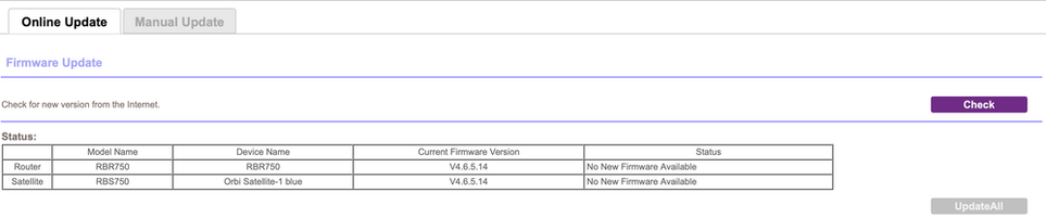

I had given up on this, but today i thought of giving it another try. The ip that shows up is 10.0.0.29, when i try to connect it, it will ask me for a username and password which for some reason its not accepting.
I cant even manually update or check the Firmware version as it doesn’t show up on the Web interface of the Orbi router. I have tried resetting it multiple times but its of no help. Attached is the picture of how it looks in the web interface.
once thing i noticed today is that if i switch off my Wifi in the laptop and connect my laptop to the satellite via network cable it does connect to internet, i even see a blue light after blinking white light when i power it up. but i am not sure why its not acting as a satellite.
non functional satelite.
I don't see the non-functional satellite here and i cant check its Firmware version. the current version is v4.6.5.14 for the router and working satellite.
