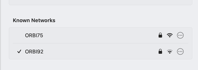

Interestingly what I do see is that the satellite which is a replacement for a failed satellite shows up in the known network list (ORBI75). The actual network is ORBI92.
I cannot access it; I assume as it is not connected to actual network. It is hardwired into the Mac Laptop.
