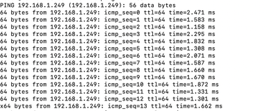

I can ping the satellite via terminal.

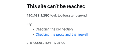

When I try to access 192.168.10.250, even after 5-10 minutes of wait time
I get
A screenshot for good measure. I have checked the firewall etc.

Success!
1- Make sure all WIFI systems are off.
2- In the end I connected to 192.168.1.250 (not 10.250) perhaps accidentally
3- Firmware is now in line with rest of system.
Thank you for helping me through this!
