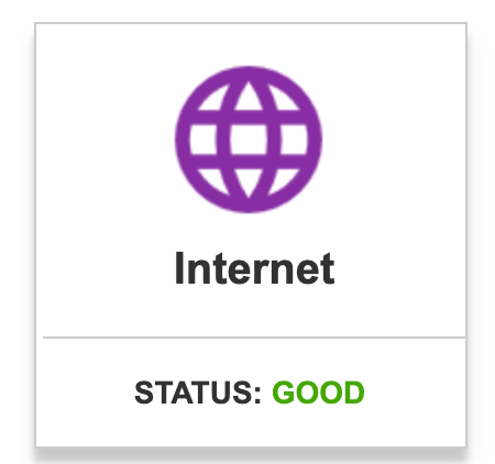

I have had major Wifi issues with this new update (7.2.6.21)
I have had major Wifi issues with this new update (7.2.6.21). It was working intense slow and hanging for all devices (probably package drops?). The interface of the RBR750 was fast. For example the ...
