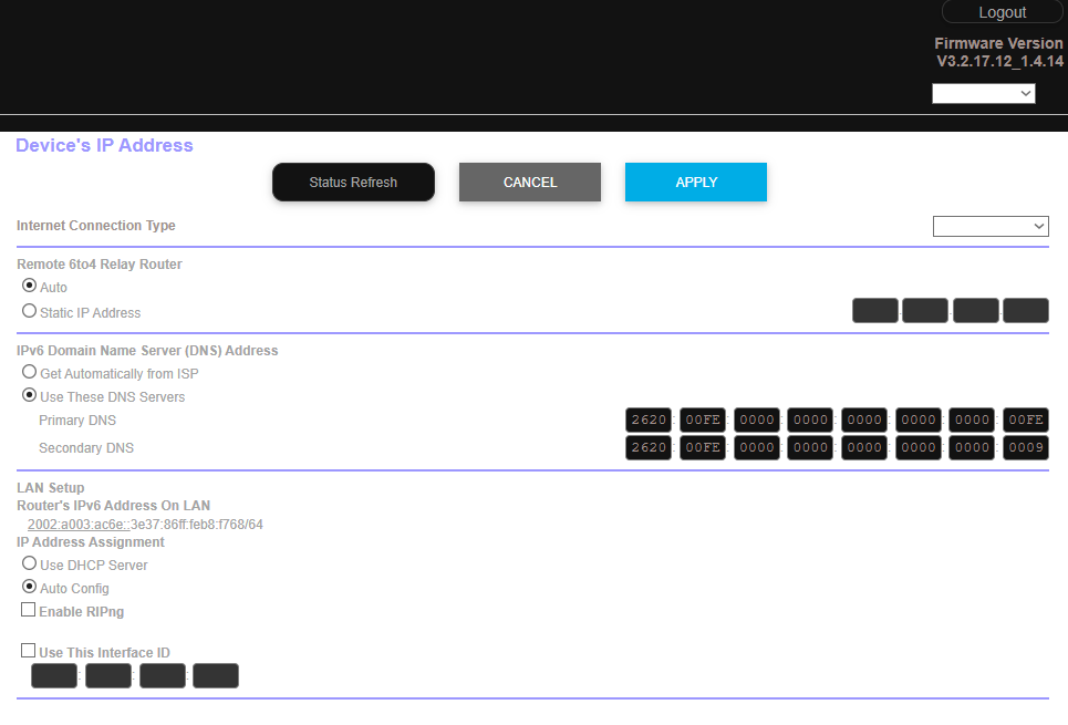

I assume the AX line does NOT have IPv6 enabled by default, so you have enabled it? If so, it's a shot in the dark, but if you disable it, do the errors persist? PERHAPS these routers handle IPv6 poorly?
https://www.internetsociety.org/resources/deploy360/2014/dns-considerations-for-ipv6/
- FURRYe38Mar 16, 2021Guru - Experienced User
I might try that and see. Right now I'm checking a different line, to see if the problem re-appears. My Windows 10Pc got a new 2.5Gb LAN card installed. It was connected however I'm trying the old Intel 1Gb wired connection to see if I see anything first.
My ISP doesn't have native IPv6 so I use the 6to4 configuration. Here what I have been using for past few months with no DNS problems until today:

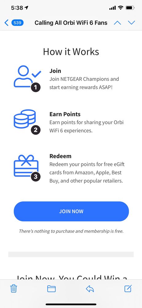

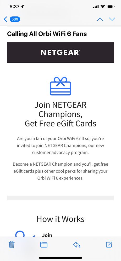

Just got this email from Netgear today asking me to join their "Netgear Champions" program to become "customer advocates" where I can earn points and giftcards for sharing my Orbi experience! Maybe we all need to join this program and see how many points we can get by sharing our actual Orbi experience....
