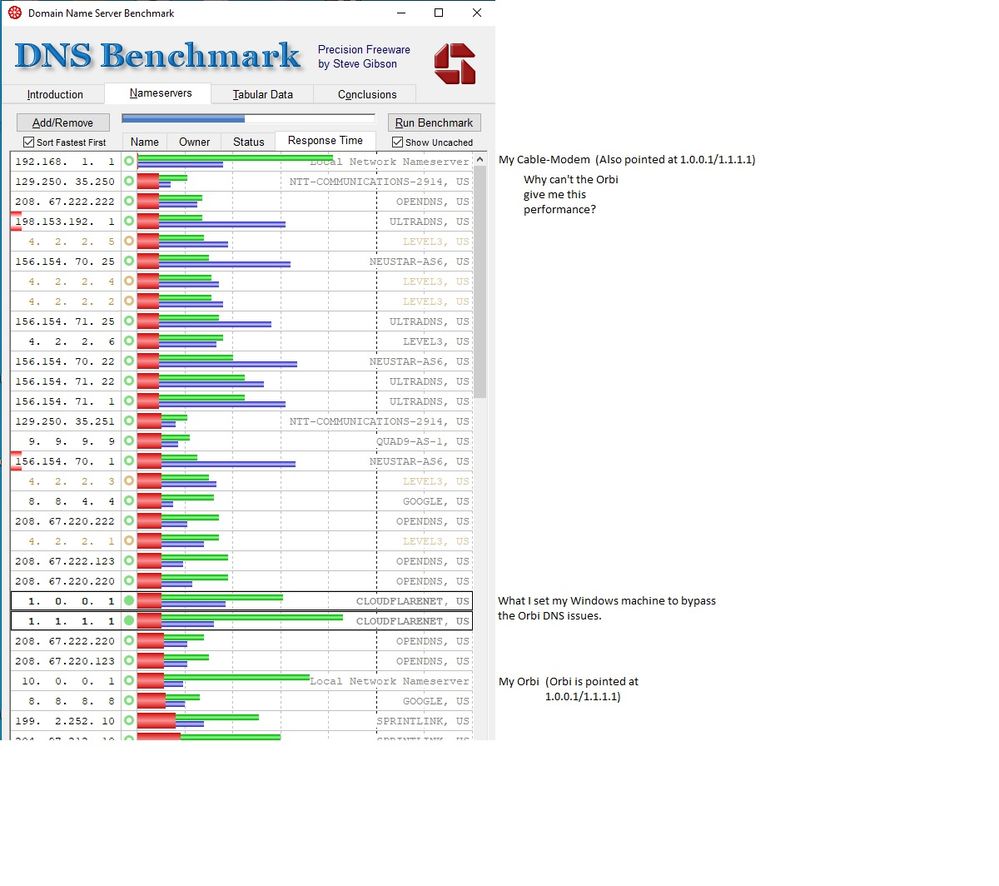

My PC is PHYSICALLY wired to the Orbi - I've overridden my PC DNS to point straight out to Google DNS due to the errors I get from the Orbi...but I wanted to upload this benchmark to demonstrate just how slow, compared to an actual local caching DNS server (my cable modem) it is in comparison. (This doesn't account for errors/rejected lookup issues.)
- rgautierApr 18, 2021Apprentice

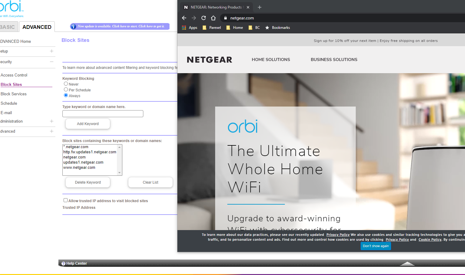

You can try the following to see if blocking the update services will work:
https://community.netgear.com/t5/Orbi/Firmware-auto-update-domain/m-p/1499659/highlight/true#M22873

FURRYe38 wrote:You can try the following to see if blocking the update services will work:
