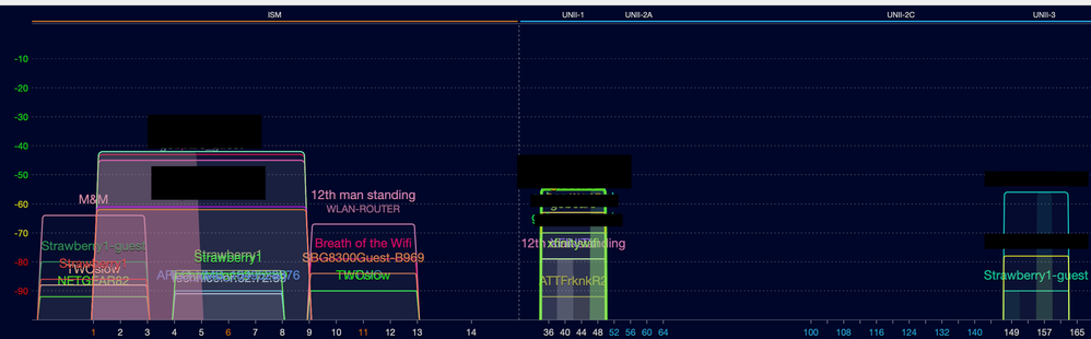

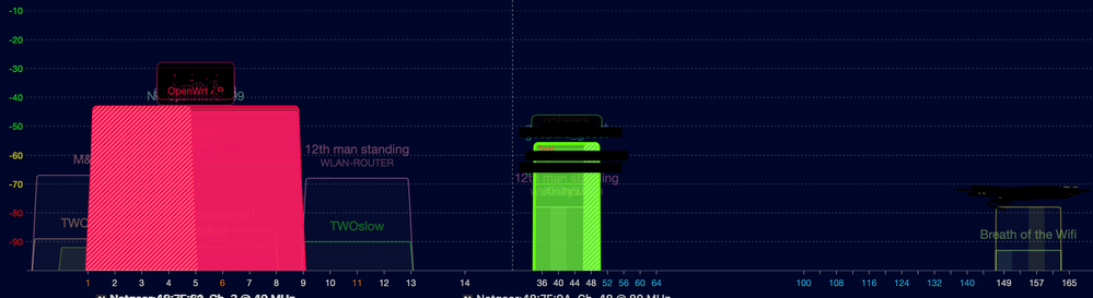

I'm the bands in red and green in the second pic -- first one is the scan of the area -- you can see there's some lower strength clusters at 1, 6, and 11 already that are other Wifi's -- with 40Mhz on, there's no way I can avoid spanning two sets of different wifi's, so being on channel 3 seems to place me around the cluster at 1 and 6 (even if I set 1, I'd presumably still conflict with the clusters at 1 and 6 unless I was at 20Mhz).
I'm almost always connecting with my phone on 5Ghz because I'm so close to a router or satellite all the time, so the graph above for 2.4Ghz is probably academic, only of relevance to devices that only do 2.4Ghz (and I don't have too many of them).
You can see the 5Ghz channel also shouldn't matter because regardless of what I set it to, it sits on the cluster in the 36-48 frequency range. I believe the 5Ghz backhaul is always on channels 149-157.
