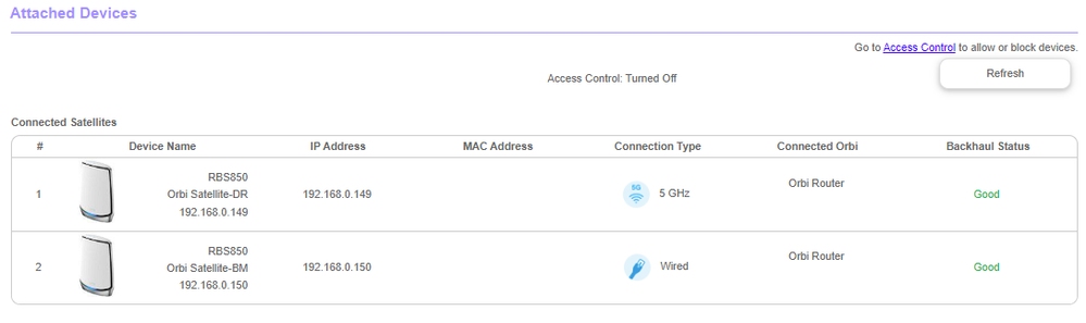

Great — let me know what you see. My wife uses sat1 hardwired for work so it’s harder to go with testing wireless only until the weekend. Since I factory reset my orbis and moved around channels, dropped to 25% power and now am on 50% I’ve been noticing weird behavior or the sat2 that should be bonded to sat1 (hardwired). I walked closer to sat1 today from being at the router for a while and saw my phone cycle on and off Wi-Fi but then also logged into the orbi app and saw it said sat2 was connected. Then disconnected. Then it showed it was Ethernet bound to the router (makes no sense) then it changed to wireless 2.4ghz to the router.
The logic on how the sat2 is connecting makes zero sense to me. Sat1 is the closest in proximity by a factor of 2 and its wired backhaul. It should be connecting at 5ghz to sat1 (which it was yesterday night before I went to bed and reset them all).
I have a signal scanner and maybe there’s 5ghz congestion, but 2.4 looks even worse and it has a longer flight path by far to the router.

- Rogelio1Aug 03, 2022ApprenticeWhen I had the Ethernet backhaul and the disconnect issue… I once sat with and observed in real-time the Wi-Fi connection / ip info page of my iPhone when it cycled between Wi-Fi, then off, then reconnected. (approx . 5 minutes). When it showed connected to Wi-Fi but with no internet, before it leased the valid ip within the subnet (reconnected for good), I could see it had a bizarre ip of like 238.x.x.x. Wish I had saved a screenshot. I’m honestly thinking there’s some dhcp lease bug associated with a device transitioning from router to Ethernet backhaul / Wi-Fi backhaul wherein it isn’t properly assigning it to the subnet and has to timeout or see it as a brand new device (forget and re-add Wi-Fi) / clear cache for it to properly dhcp again.
- Rogelio1Aug 04, 2022ApprenticeTo confirm — 169.254.x.x was the IP address that was reported from my iPhone in the brief period of time when it was not leased a working valid connection ( stuck in its 5 minute loop of being disconnected and reconnecting). This is what the internet tells me:
If you see a 169.254. x.x address, it means that the DHCP server is not reachable. The PC will not work because there is not a router to or from that PC. Troubleshoot this by finding out why the PC cannot see the DHCP server.
I went back to plugging in the Ethernet to the sat1 today to recreate this and get the ip but will unplug it again to test over the weekend. I got the disconnect issue within about 6 hours after reconnecting the Ethernet cable — it’s like it takes some time to begin this failure mode of clients moving around not able to get an immediate dhcp lease. - FURRYe38Aug 04, 2022Guru - Experienced User

- satellyAug 08, 2022Aspirant
By any chance do you have a switch attached to your Orbi router? I had similar problems with intermittent drop out when moving from main router to satellite, although much less frequent than you. Reading the forums, there were some comments about Orbi not working with "green" switches and since changing this, things seem to have improved.
- GarwoofooAug 08, 2022Apprentice
I think at this point this is looking like one of three things:
- The Orbi has an issue with satellites connected via Ethernet
- The Orbi has an issue with satellites connected via Ethernet which are connected behind a switch
- The Orbi has an issue with a mixed combination of Ethernet-connected and wireless satellites
Since moving both of my satellites to wireless, I haven't seen this issue at all, but it doesn't help me narrow down which of these issues it might be.

- Rogelio1Aug 08, 2022Apprentice
For what it's worth, I do have a Netgear 8 port switch (GS108T) / not a "green" switch, but it's not plugged between any routers and satellites... I have it plugged into the router directly to provide/expand wired ethernet to 7 additional devices near the router. The LAN ports of my router are occupied by one connected to this switch, one connected to Sat1, and the other two are just single LAN devices (computer, etc.). I have no switches plugged into Sat1 (just LAN devices -- computer, printer) nor do I have switches or anything for that matter plugged into Sat2 via LAN.
So far with disabling Sat2 I haven't noticed the wifi disconnects on my iPhone walking between Router and Sat1 (ethernet connected)... still needing to test for a handful more days to confirm this resolved it. - Rogelio1Aug 08, 2022Apprentice
Also worth noting, I tested using a 5-port Netgear switch both plugged into Sat1 and in-between Router and Sat1 (with the hardwired ethernet coming into the switch and/or Sat1). In both instances, the wifi disconnects occurred when Sat2 was on regardless of the introduction of the 5-port switch plugged into Sat1 or between router and Sat1 (or with no switch at all here)... so I'm leaning towards the theory it's an issue with mixed ethernet + wifi backhaul combos with 2+ satellites.
