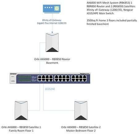

AX6000 WiFi Mesh System (RBK853) 1 RBR850 Router and 2 (RBS850) Satellites. Xfinity xFi Gateway (1200/35), Netgear JGS524PE Main Switch. Wired Backhaul to Main Switch. This is similar to the ...

- ksupersano18Nov 02, 2022Aspirant
- FW - 4.6.9.11_2.3.5
- It is an xFi Gateway from Xfinity
- Model:CGM4140COM
- Vendor: Technicolor
- Hardware Revision:2.2
- Cable's are fine, green features disabled, but likely irrelevant since the Router is before the switch.
- Dumb question but will turning down the power impact throughput speed?
- They are all kind of stacked on top of each other floor to floor, (almost directly above each other on each floor) so max definitely less than 30 feet between them. But again might be irrelevant since I am using Wired Backhaul
- All the Apple stuff disabled.
I have read many posts on this, this seems isolated to the RBR only. The devices roams fine. If I go upstairs and it roams to the 1st floor satellite, boom, problem solved.
- FURRYe38Nov 02, 2022Guru - Experienced User
ksupersano18 wrote:
- FW - 4.6.9.11_2.3.5 <Has a factory reset and setup from scratch been performed since last FW update?
- Model:CGM4140COM
- Hardware Revision:2.2Your ISP Modem already has a built in router and wifi. This would be a double NAT (two router) condition which isn't recommended. https://kb.netgear.com/30186/What-is-Double-NAT
https://kb.netgear.com/30187/How-to-fix-issues-with-Double-NAT
Couple of options,
1. Configure the modem for transparent bridge or modem only mode. Then use the Orbi router in router mode. You'll need to contact the ISP for help and information in regards to the modem being bridged correctly.
2. If you can't bridge the modem, disable ALL wifi radios on the modem, configure the modems DMZ/ExposedHost or IP Pass-Through for the IP address the Orbi router gets from the modem. Then you can use the Orbi router in Router mode.
3. Or disable all wifi radios on the modem and connect the Orbi router to the modem, configure AP mode on the Orbi router. https://kb.netgear.com/31218/How-do-I-configure-my-Orbi-router-to-act-as-an-access-point and https://www.youtube.com/watch?v=H7LOcJ8GdDo&app=desktopTry option #2 first.
- Cable's are fine, green features disabled, but likely irrelevant since the Router is before the switch. <Cable ARE relevant AND important here. Can impact over all operation and performances. CAT6 is recommended.
- Dumb question but will turning down the power impact throughput speed? Some.
- They are all kind of stacked on top of each other floor to floor, (almost directly above each other on each floor) so max definitely less than 30 feet between them. But again might be irrelevant since I am using Wired Backhaul <Distance in between, regardless of wireless or wire connected IS relevant. Less that 30 feet is too close to each other. Try turning OFF one RBS and see how things work. Too Much Wifi: https://youtu.be/UR0viMLISz4
