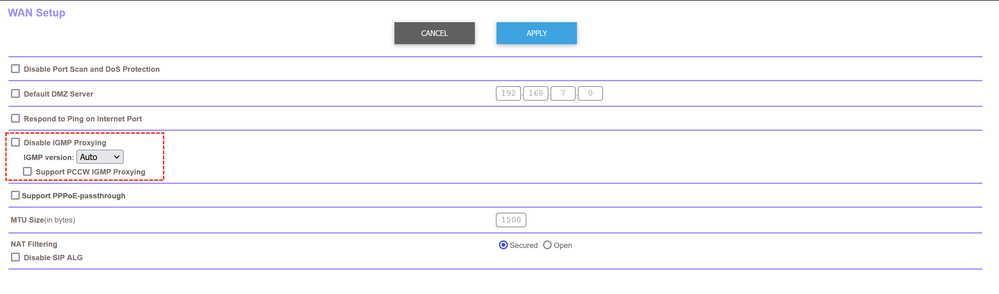

I have an issue with the IPTV box connected in my system. Ideally, the ISP provided setup should look like this: How I have it connected: Right now my gateway and the access p...

My concerns are the probably workable IGMP proxy (IGMP level unknown), the dual-NAT situation with two NAT routers in the data path - not convinced about the IGMP snooping and multicast support. However, things might have changed since introducing the v7 bringing a major change to the RBR850/RBS850. Looks like I have to find some second-hand device in the market here, since I'm not Netgear 8-)

The devices I had were dedicated for Dannish market. I think the functionality there, that allowed for this setup to work, must have been generic. So if I understood correctly, its the IGMP support that is missing in the Orbi system? If yes, do you see any workaround here? I see something related here:
