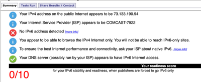

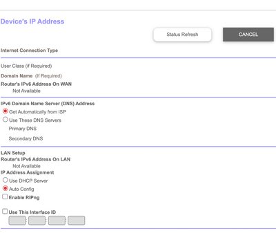

Firmware is V4.6.8.5_2.1.9. It worked for 15 days. Both the IPv6 test page and Orbi router page indicate no configuration:

Whats the system Uptime show on the RBRs debug page? Just curious. Router IP address/debug.htm
- donawaltAug 01, 2022Hero - Experienced User
I found it, disregard private message....it says
System Uptime: 0 days 08:27:51
So about 8 hours ago it restarted.Interesting, not sure why it did that. No evidence of power fail in the house and I did not do it.
