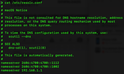

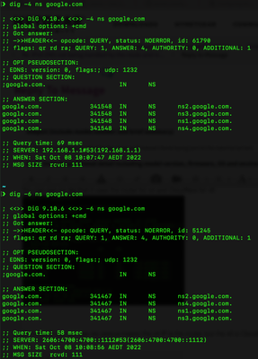

You can see via dig that it uses the router for v4 and Cloudflare for v6

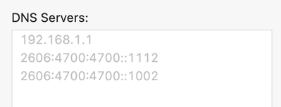

You can also see via various means the v4 IP is the router, but the v6 is Cloudflare

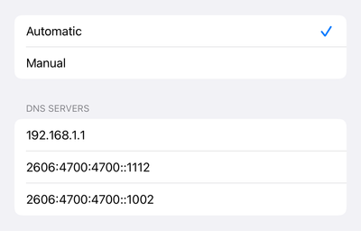

And this is from an iPad:

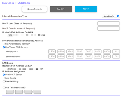

I have CloudFlare and Google DNS configured as the DNS servers on my Netgear RBR50 Orbi router. This is what a Windows 10 computer reports:
DNS Servers . . . . . . . . . . . : fe80::a204:60ff:fe1c:239%22 192.168.1.1 fe80::a204:60ff:fe1c:239%22
Windows is using the router for DNS. (fe80: is a local IPv6 address, not a public IPv6 address.)
In the past, I have often played around with defining static DNS servers on the PC. Perhaps CloudFlare has been set on the computer?

I use PPPoE with a Tagged 201 VLAN on the WAN and I'm showing what I have set as the IP Address for IPv4; and the DNSs that I have set for IPv6. Not sure if depends on how you have to log into your service how DNSs are utilized. I'd love to test it out, but am locked into how much I can do with my login method.
