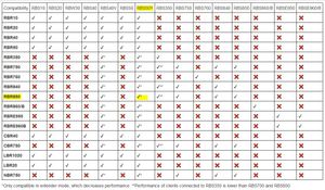

Is the RBS50Y compatable with the RBR850?
I'm looking for an outdoor solution for my RBR850 router with three RBS850's already attached to it. Support told me that the RBS50Y Extender would work with my setup, although I'm seeing mixed infor...

    The original RBS50Y worked only with the Orbi RBR50 and RBR40 routers.  The RBS50Yv2 has two firmware modes, satellite and WiFi extender.  In extender mode, the RBS50Y2 is compatible with any WiFi router on the market, from any vendor.  This is because WiFi Extenders do not become part of the "mesh" system.  It may have the same WiFi SSID/password (identical - exactly) as the Orbi system, but devices will not roam seamlessly between the two systems.  Often, this is not a problem because devices connected to a WiFi extender are not mobile (cannot "roam").
