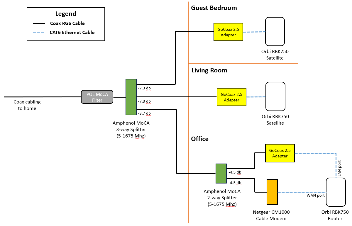

Thanks Furry. The only thing that's outstanding for me is that with the introduction of MoCA in my network setup, I had to add 2 splitters which increased my cable modem upstream power levels - they're right now sitting at around 50-51 dbmV. Before I installed MoCA, upstream power was ranging around 48-49 dbmV.
With my MocA setup, I haven't yet experienced internet drops or connectivity issues despite the higher upstream levels. Even so, I feel the power levels are really at the top acceptable threshold and any random blip may cause a disconnection. Since I need to use splitters, are there splitters that are lower loss than others that still are MocA compatible frequency-wise?
I've attached a schematic so you can visualize my setup and splitter output terminal db loss.
