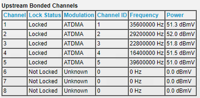

Thanks Furry - the article mentions that "Good Upstream power levels are within 38-48 dBmV," so in my case I'm a little past the max 'good' range being at 50-51 dbmV. I've been checking throughout today and the upstream levels have fluctuated a tiny bit up to as high as 51.5 and other channels back down to 50.x dbmV. I work from home and have not noticed any internet connection issues still (knock on wood).
Since I installed MoCA, the modem logs show nothing and the modem has been up for about 15 hours now. Just checked a minute ago and still no log entries.

So to update, still with my MoCA setup, I swapped out my 2-way splitter originally having -4.5 db loss for both output terminals for another 2-way splitter that has -3.5 db loss to each terminal. The hope was that swapping the splitters would have a positive impact to lowering my upstream power levels slightly.
Looked at the cable modem signals and downstream remained the relatively the same as before, but the upstream levels actually increased! Definitely was not expecting that - I was thinking that the power would go down very slightly. Before I had power between 50 - 51.5 as the max.
I had restarted the modem and still got these stats. The modem has been up for roughly 15 hours now, no drops, no disconnects, and internet working fine as it did before. Modem log is empty.
Is this expected?

donawalt on the Xfinity forum, some of the 'experts' firmly disagree with those specs. They are stating that upstream power should reside around 35-50 dmbV as the optimal range and that my current levels now do not offer a buffer for fluctuation. They also mentioned that some modems have chipsets that are slightly more tolerant in higher max thresholds than other modems, which may explain why my modem hasn't rebooted or dropped connection.
I'm tempted to contact Xfinity to see if they can check out the connection from the street to my house, but on the flip side, I don't want them to inadvertently screw anything up which they have done before... The "wait and see" part has been fine so far, as I haven't experienced any internet issues yet with my MoCA setup, but not sure if I continue to wait or if it's worth it to get a tech out.

You haven't shown your modem status page (there was one image post that did not show up for me in your post earlier), are you getting lots of uncorrectable errors on a daily basis? In your log, are there a lot of CM-STATUS messages, especially 16 and 24?
- unioncorpsAug 07, 2023Guide
Since I installed the new splitter, I'm getting 51-51.5 dbmV for upstream power across the 5 bonded channels and no uncorrectables. CM log is empty.
- donawaltAug 07, 2023Mentor - Experienced User
Sounds excellent! If it was me I would just watch it - with no errors and no warnings, it's hard to imagine a concern imho.
