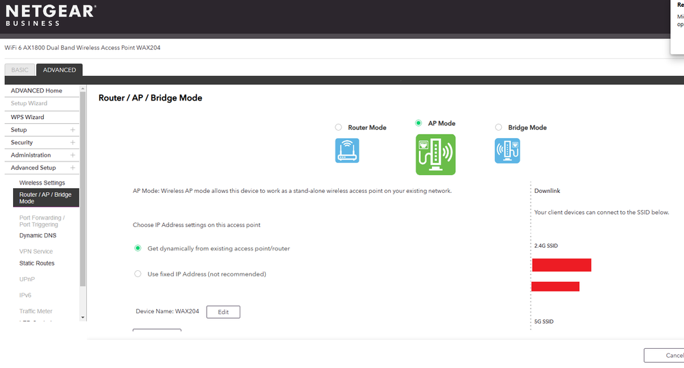

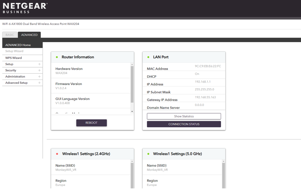

Issues connecting AP to Orbi network
I have an Orbi network (RBR750 and two RBS750 satellites). In itself, this works great. I want to connect an access point to the network. I am trying to use a Netgear WAX204 in AP mode. The AP is...

I can confirm that it is definitely in AP mode. It actually has three modes - (1) Router (2) AP and (3) Bridge. It's in AP mode.
I'll try and get a screenshot (just have to jump on my other PC).

In ap mode, the primary router should be assigning an IP address to it and the AP not trying to pull its own.
100% agree. That's what I expected and, indeed, what I want. It just isn't happening. EDIT: Also this is what happens when connected to my phone, just not the Orbi network.
