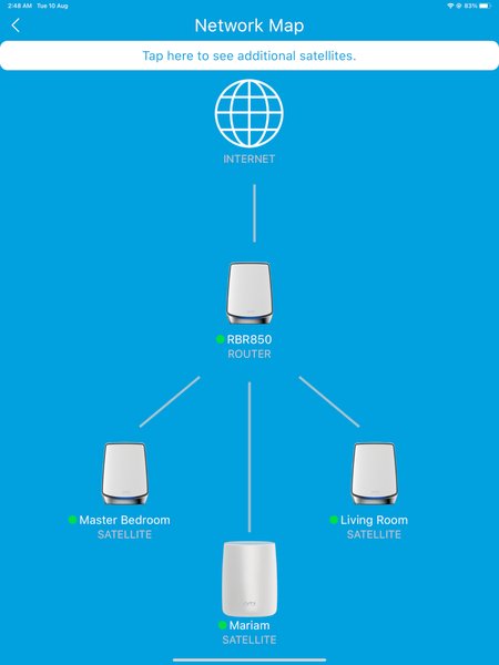

Issues connecting RBR50 as a satellite
Hi, I have an RBK853 and an RBK53. I setup the RBR850 as the main router, 2 RBS850s as AX satellites, 2 RBS50 as AC satellites, and I also connected the RBR50 as a satellite. The RBR50 shows u...

Seif wrote:
Target:
1) Disable the RBR50's own wifi SSID. Not supported on Orbi systems.2) Be able to connect to the RBR850 main network, through the RBR50 as a satellite. Not supported on Orbi systems. 50 series Orbi is NOT compatible with Orbi AX systems. You can either connect RBS50 series to Orbi AX system is all
- SeifAug 10, 2021Aspirant
But the RBS50s are working perfectly with the RBR850, same wifi name, no problems at all.
My issue is specifically with the RBR50.
So it's an RBR issue, not a 50 vs 850 issue.- FURRYe38Aug 10, 2021Guru - Experienced User
The RBR50 can't work as a RBS, only in router or AP mode and would be a separate SSID wifi network if you connected it to the Orbi AX system in AP Mode.
Is the RBS50 wireless or wire connected to the Orbi AX system?
- SeifAug 11, 2021AspirantThe RBS50 is wired to the AX router
