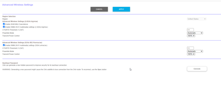

Armor, and Traffic Meter and Set 20/40Mhz Coexistence to 40Mhz only. Set CTS to 2347. Set Short preamble instead of Long preamble modes. Save settings and reboot the router and satellite(s). Under Advanced Tab/Advanced Settings/Wireless Settings.
Try disabling AX mode on the RBR under Basic Tab/Wireless seeings, uncheck the box next to 2.4Ghz.

THis is what settings I had. See attached photos. I have charter internet. ARRIS TM1602A modem. My home is 2 stories. about 3800 sq ft. My router is connected to the modem on far end of basement. Then satellite on other end of first floor and the other on 2nd floor mid floor plan. I would say my other neighbors have wifi but not sure on type.

Also try turning down the power output of the RBRs wifi radios from 100% to 50% and see if this changes anything. Under Advanced Tab/Advanced Settings/Wireless Settings
