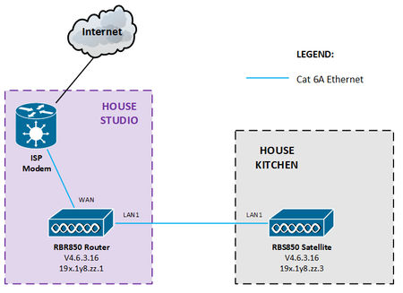

Issues with RBS850 Satellite on a RBR850/RBS850 System
Hello Netgear Support Community: I would like to ask for advice and suggestions regarding problems I have been experiencing with the connection between a RBR850 Router and a RBS850 Satellite. I ...

With all these things, I would like to ask for help regarding how to solve this issue:
- Is there a way to ensure that the connection between devices will always be up and running? How can I get rid of this Satellite Connection issue? Is this a bug/caveat of the firmware version?
What happens if you swap RBS location around with each other? Does the problem follow the RBS or remain at the one location?
- Why does the Satellite Status page seem to show that the connection between the Router and Satellite is always as Wireless (as seen in Figures 3 and 4) regardless of the fact that both devices are always wired? Is there a way to know from the Satellite Status page that both devices have a wired connection?
Are the RBS directly ethernet conencted to the back of the RBR or is there a LAN switch in between?

Hi. Thanks for answering my post. The requested info is:
Answer: The ISP ONT/Modem manufacturer is Huawei, the model is EG8145V5.
What is the size of your home? Sq Ft?
Answer: 1600 sqf. But I must mention that I am not located in USA. I am located in Ecuador (LatinAmerica). Here, houses are built quite different. All inner walls are made of bricks and concrete. WiFi signal degrades easily from one room to the other. My house area in sqf is not comparable to a house with similar area build in North America when analyzing WiFi propagation.
What is the distance between the router and 📡 satellite(s)? 30 feet or more is recommended in between RBR and RBS📡 to begin with depending upon building materials when wirelessly connected.
Answer: 38 feet. But it shouldn't matter. I don't want my router and my satellite to be wirelessly connected. My satellite is connected to the router by using a Cat6A UTP cable. A wired connection is always far better that any wireless connection. If I would have the choice, I would turn off the wireless backhaul, so I force the satellite and the router to use the wired connection. I want them to work using the UTP cable.
Has a power off for 1 minute then back ON with the ISP modem and Orbi system been performed since last update? A complete pull of the power adapters.
Answer: Yes. Several times.
Answer: I haven't tested this scenario, and honestly I won't. I worked very hard to ensure the best places where the router and the satellite will be installed (power connections, ethernet connections, secure and optimal locations, away from any other electronic devices and electromagnetic interferences, location where the strongest WiFi signal is needed, etc.). The places where they are installed now are the places where they are supposed to be.
Answer: They both are directly ethernet connected. No other LAN devices in between.
