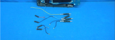

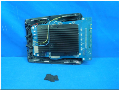

The business about antennas is a bit confusing. There are "Eight (8) high-performance internal antennas
with high-power amplifiers". https://www.netgear.com/images/datasheet/orbi/RBK852.pdf page 4.The FCC submission clearly shows eight antennas:
Here they took out the antennas (8)
This leaves me with a distinct impression that four antennas are used for the 4x4 5G backhaul link and four antennas are shared by the 4x4 2.4G and 5G user radio links. Seems (to a country person) that any given antenna can be broadcasting (or receiving) at 2.4G or at 5G, but not both at the same time. (as well as not broadcasting and receiving at the same time).
"Marketing Speak", indeed.
