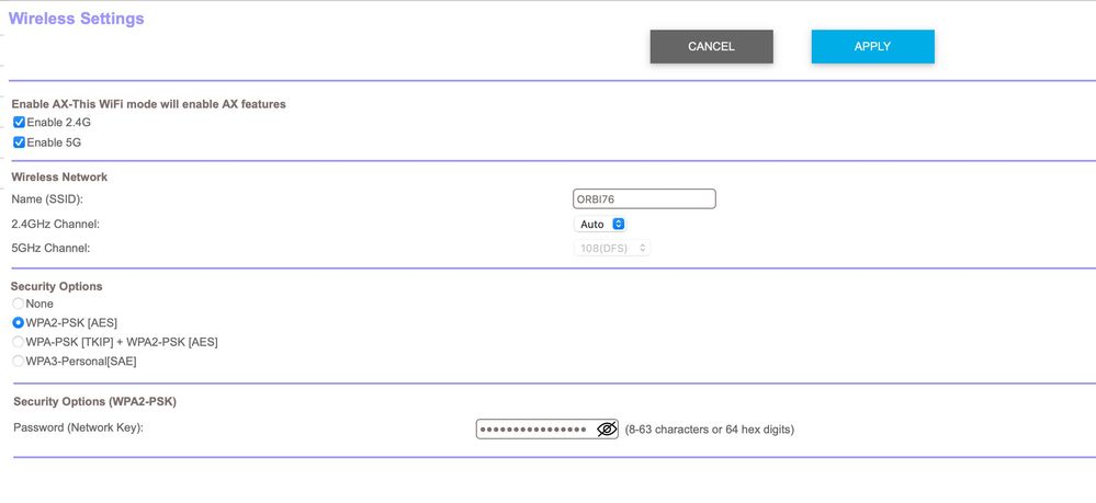

I can modifiy the channel for the channel 2.4Ghz but not 5 it's greyed out.
Since I have done the following settings, my satellite are not joining anymore, even by reseting them or bringing them closer..

Also can you show us the wireless settings page with the 5Ghz channel being grayed out?
You should be able to select 36 thru 48 for 5Ghz.
Try a different browser by chance?

Here are my settings showing the settings for 5Ghz greyed out (it's greyed out with every browsers Chrome, Safari, Firefox..)

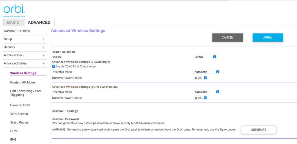

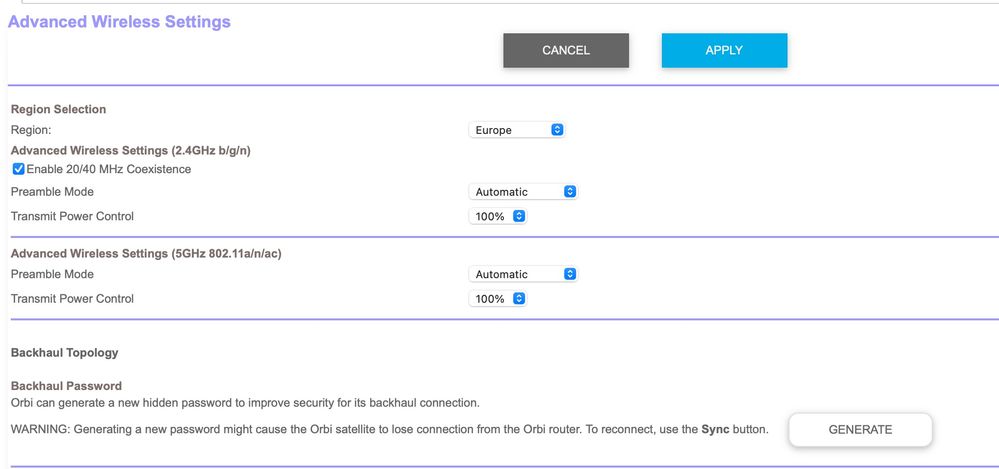

Here are the only advanced settings available to me by the way on the router :
Thanks
Thanks
