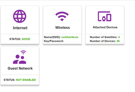

When I log onto my routers through a browser interface, the connected Satellites do NOT show up.
As can be seen below, I have 4 satellites connected.

The satellites are definitely connected and we can see devices connected to them.
If I unplug a satellite, it shows up as a disconnected satellite. When I plug it in, it no longer shows as a satellite, but it is definitely connected.
