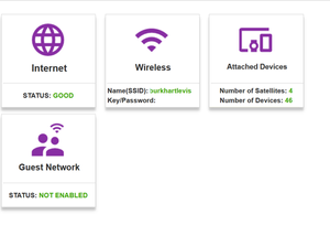

Mesh Router RBR850 Does NOT show Connected Satellites on Web Display
I hope this is the correct forum.
When I log onto my routers through a browser interface, the connected Satellites do NOT show up.
As can be seen below, I have 4 satellites connected.

Has the router been restarted? (Then, wait at least five minutes for things to settle down.)

As mentioned, I'm using Edge and the firmware is the latest. Support updated all firmware.
My issue is that although satellites are connected to the router, they do NOT show up on the web link.
They show up connected in the app.
I'm thinking I may have a hardware problem as the satellites seem to disconnect.

If the RBS are showing up in the Orbi app and not the RBR Web ui, would not be a hardware issue. Something on your PC or web browser may not be working right or something on the RBRs web UI is not working right.
