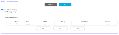

Potentially of note is that for my ISP I needed to 'enable VLAN / Bridge setup' and it is set as per the below.
