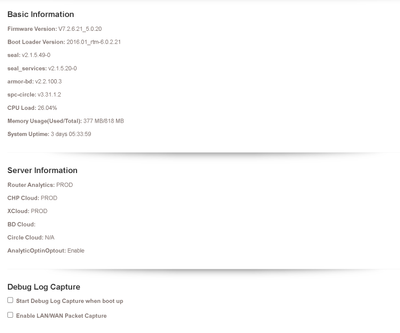

Please post a screen capture of the RBR debug page found at RBR IP address/debug.htm in your next post please.

Everything is running 7.2.6.21 firmware.
