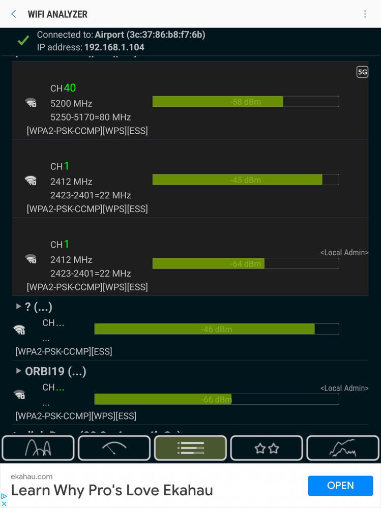

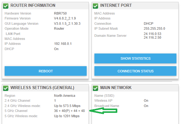

So something strange is happening when I try to change the 5 GHz channel. By default, the interface at 192.168.1.1 shows it's on channel 48. When I look at it on my WiFi Analyzer app, it shows that it's on channel 42, which doesn't make any sense.
Looking through other posts, it sounds similar to this post: Orbi RBK852 - Selection of 5GHz channel 36 - Page 2 - NETGEAR Communities
No matter what channel I pick, it always shows that it's on channel 42, just like FarmerBob1 said. That post looks like it's a couple years old. Any idea on a resolution? I wonder if that's part of the problem.
- Klinger123Apr 28, 2022Aspirant
And I reduced the power output to 50%. Will report back.
- FURRYe38Apr 28, 2022Guru - Experienced User

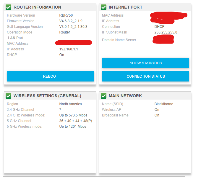

Ya should not be on channel 42 if you select 48.
What is displayed on the Advanced Tab page seen here:
And here are screenshots of the channel info.
Both appear to show Channel 42 as the main channel.

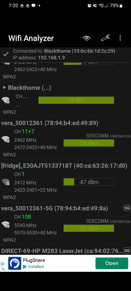

What does the graph button show in the list of SSIDs and the channels seen here on that wifi analyzer?
Do you mean this?

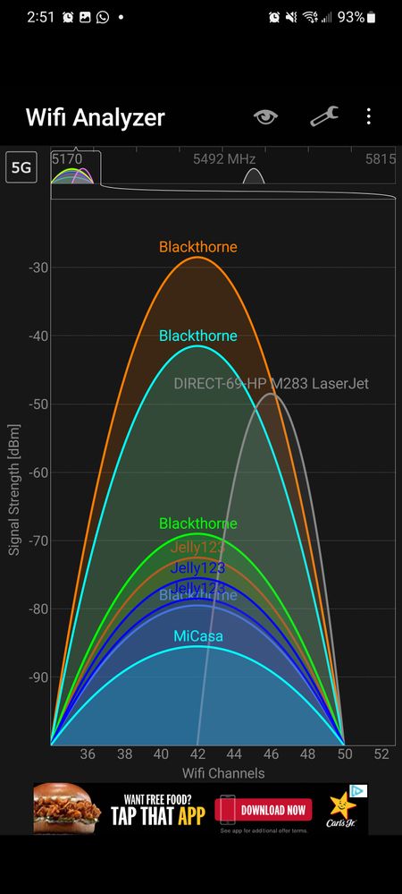

This one if you have this one on the app:
- Klinger123Apr 29, 2022Aspirant
Is this what you wanted?

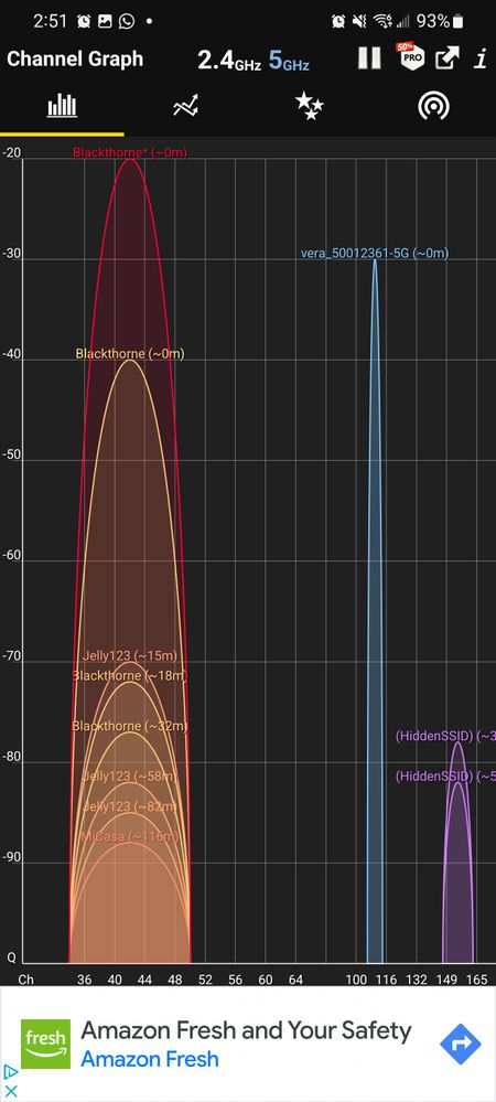

- FURRYe38Apr 29, 2022Guru - Experienced User
Yes, select the SSID that belongs to your system, Look at the channels there. Whats listed there. Be sure to edit out MAC addresses if you post.
This list will tell you what exact channel the Orbi is using.
So it does show the correct channel value when I go to that screen.
