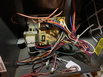

Wellll....the downstairs thermostat went dead overnight. I pre-ordered Google's power adapter. It says it will be here June 8-9.
Here's a link:
https://store.google.com/product/nest_power_connector?hl=en-US
turbojimmy2
Jun 11, 2021Guide
I installed the Nest C-wire adapters today. Pretty straightforward installation at the air handler. Time will tell if it works. Both thermostats immediately started showing more battery power so that's a good sign.
