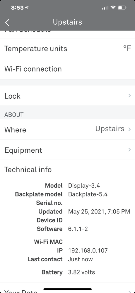

Current readings on my 3rd gen NEST:
This is up from 3.71 from last nite when I made the changes.

One Nest is about 15 feet from the RBR. The other is about 20 feet from the RBS. The one 15 feet away does die faster. The one near the RBS lives longer now that I put the RBS further away from it.
Still, the only sure way to fix it for me was to put the Nest thermostats on their own, non-Orbi WiFi network. Voltage has been consistently 3.87-3.88 on both of them.
