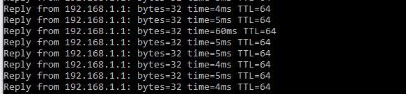

- ZipsyNov 09, 2020Aspirant
Here is the chart but in game the network round trip time spikes in sort of a pyramid shape. It seems that the real effects of this are apparent in game when it spikes. The first one is an image of the ping when connected to the router.
This is an image of the ping when connected to a satellite
The ping on the satellite is better than when the router is. The satellite is right next to my laptop so distance shouldn't be an issue. - FURRYe38Nov 10, 2020Guru - Experienced User

Are ping times the same if you ping the routers LAN IP address?
- ZipsyNov 10, 2020Aspirant
The ping spikes are still there it's just the overall ping is lower.
