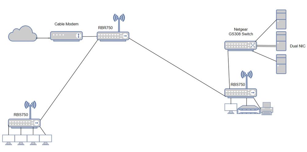

- FURRYe38Jul 14, 2021Guru - Experienced User
What is the brand and model# of the switch being used in the configuration?
Where is this switch placed and located at in the configuration?

- RavepantsJul 14, 2021Guide
Hiya,
the switch is a netgear GS308, I have attached a basic diagram, apolgies for the roughness.
