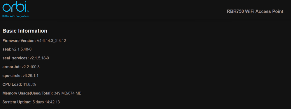

Mar 08, 2023Guru - Experienced User
I would do a factory reset and setup from scratch as well.
My RBK752 has been online for 5 days and working good on this version of FW.
RBS ethernet connected.
