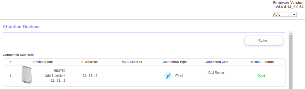

Ok, got my RBS750 ethernet connect to a HP ProCurve switch thats connected to my RBR750 running v14:
I'll leave this run for a bit and check on it after a while.
- FURRYe38Oct 11, 2021Guru - Experienced User
So left my 7 series RBS ethernet connected since yesterday. I was playing some CoD gaming with my game console ethernet connected to a R7800 that was in wireless bridge mode that was connected to the RBS thats ethernet connected to the RBR. Saw no issues all day. RBS was wirelessly connected first since I had to move it closer to the RBR where my long ethernet cable could reach. After the RBS was wirelessly connected I plugged in the ethernet to the Switch thats connected to the back of the RBR. I saw the RBS front LED turn ON BLUE and then after a few minutes, turned back OFF. Ok so far.
Iphone, pad and Mac Book all connected to the RBS as well.
