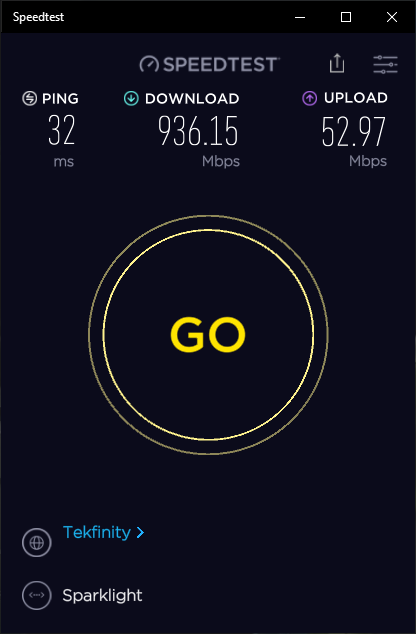

Ok, RBR750>GS308v3>wired PCs.
Windows 10x64 connected:Mac Mini 2012 connected.
Saw same speed test results.
Also OSX has a 2Gb update that I started and saw it download thru the GS308 successfully.
