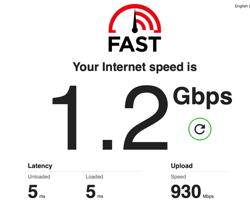

Ok, to clear the record, apologies to Netgear. Netgear unfairly took criticism from me in these forums. They responded to my email inquiry, opened a case and was prepared to do exhaustive dive with engineering to resolved. However it turns out the problem was not with the Orbi or the switches I've tried, problem was with a new Macbook dock.
I've been up for a solid week, no interruptions since removing the USB - C dock w/ethernet connection. I substituted an Ethernet to USB-A adapter plugged into the same dock's USB-A port and have had no interruptions or reboots to my Orbi RBK753 /D-Link Switch System since. I am amazed that one stray device (the dock's ethernet) could actively wipe out a switch like that...but now I know.
Router hardwired to 2 satellites and 1 D-Link DGS108 switch, everything smooth, super fast and great wifi Coverage.
Here's my ethernet connectivity past week every time I've checked, I don't think it can get much better in my area:
The only suggestion I made to Netgear at end of it, was to put more messages in the standard log so mere mortals could at least get a clue what might be causing problems when networking isn't stable. In my case, if the log had shown "disabling DHCP to Swtich due to xyz" would have saved me dozens of hours of troubleshooting. Netgear could probably save some customers by more verbose logging and perhaps a searchable index of "known trouble issues/components"
