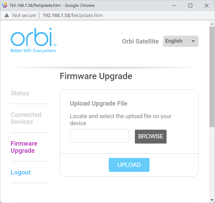

Mar 28, 2022Guru - Experienced User
Need to be sure you unpack the .zip file. Then select the unpacked FW file on the RBSs web page. Send the FW file directly using the RBS web page. Use MS Edge or Firefox for this.
0002mantt wrote:
I update the RBK7503 with two satellites. Only the router was updated. The satellites were not.
I tried updating manually by downloading the zip file. It says
Any advise?
0002mantt
Mar 28, 2022Tutor
I did. I unzip the file and upload "RBS750-V4.6.7.13-signed.chk". The earlier post was the error message I received.
- FURRYe38Mar 28, 2022Guru - Experienced User
Try MS Edge or Firefox?
- 0002manttMar 28, 2022Tutor
Tried both Firefox and Edge with the same error.
- Mikey94025Mar 28, 2022Hero
0002mantt wrote:Tried both Firefox and Edge with the same error.
I suspect you are not using the web manual firmware update tool for satellites correctly. It is not done on the same page where you update the router firmware. You do not go to the Manual Update page, browse for the file in the top section, check the boxes for your satellites in the bottom section, and press the UPLOAD button in the top section. Note that there is a horizontal line separating the top section, which is for the router, from the bottom section which helps you update satellites.
Instead, in the section BELOW the line check the box for a satellite and press the UPDATE button. A new, small window will appear where you can browse for the satellite firmware and then update that one satellite. This is what you should be using for the satellite. Is this what you are using and that is failing with the error you posted?
